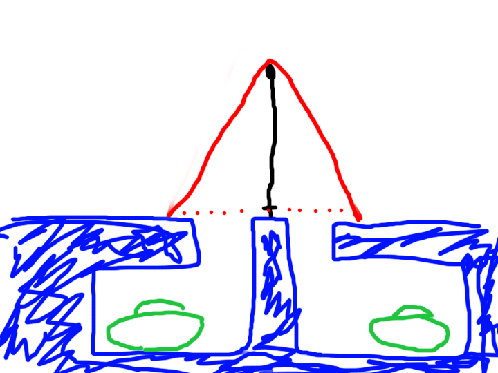

    I believe he means .....
    Dig a hole in the snow and have the tent, no floor, set at the ground level. That way the floor is lower and the top of the tent is higher.
    From LINK.
    I thought this was a great and interesting drawing. I have never had the pillars, I just dug out a huge space underneath. I had a kitchen area and room for 2 sleeping bags. The sleeping areas were also places to sit. I used my Black Diamond Betamid.
    I do miss lots of snow, but I love NC.
    "snwcmpr"

    @snwcmpr What I'm referring to is more like this:
    The main point is to get the heattrap working. Then you will have about 0 degrees Celsius in the "living room" and subzero in the access area.
    Picture borrowed from this site - sadly only in Norwegian.
    This is basically the same construction principle as the Inuit igloos. You don't want to sleep in the coldest (lowest) part unless you have to.

    The heat-trap or cold-pit (canal) as we call them serves two purposes. It gives you more "headrom" so you can cook and dress standing up. If you make sure the pit can drain the cold air (the tent should be in raised so that you have an inclination from the opening), then it wil also contribute to keeping the temperature on the upper level inside the tent at a more comfortable level. If you just dig a pit the cold will accumulate and build up within. This picture should give you an idea

    With isolated walls and roof, like a snow cave, igloo or a thick cotton tent, the cold pit has its mission. But with thin nylon walls, this has no meaning. The warmth get right trough the walls, and it is just the power of the stove that is holding a comfortable temperature inside. When shuthing down the stove, the temperature will drop to near outside temperature in short time, and it is the isolation of the sleeping bag that will give you a comfortable sleep. A canal out of the vestibule or flat floor, will do absolutly nothing for the temperature inside the tent.
